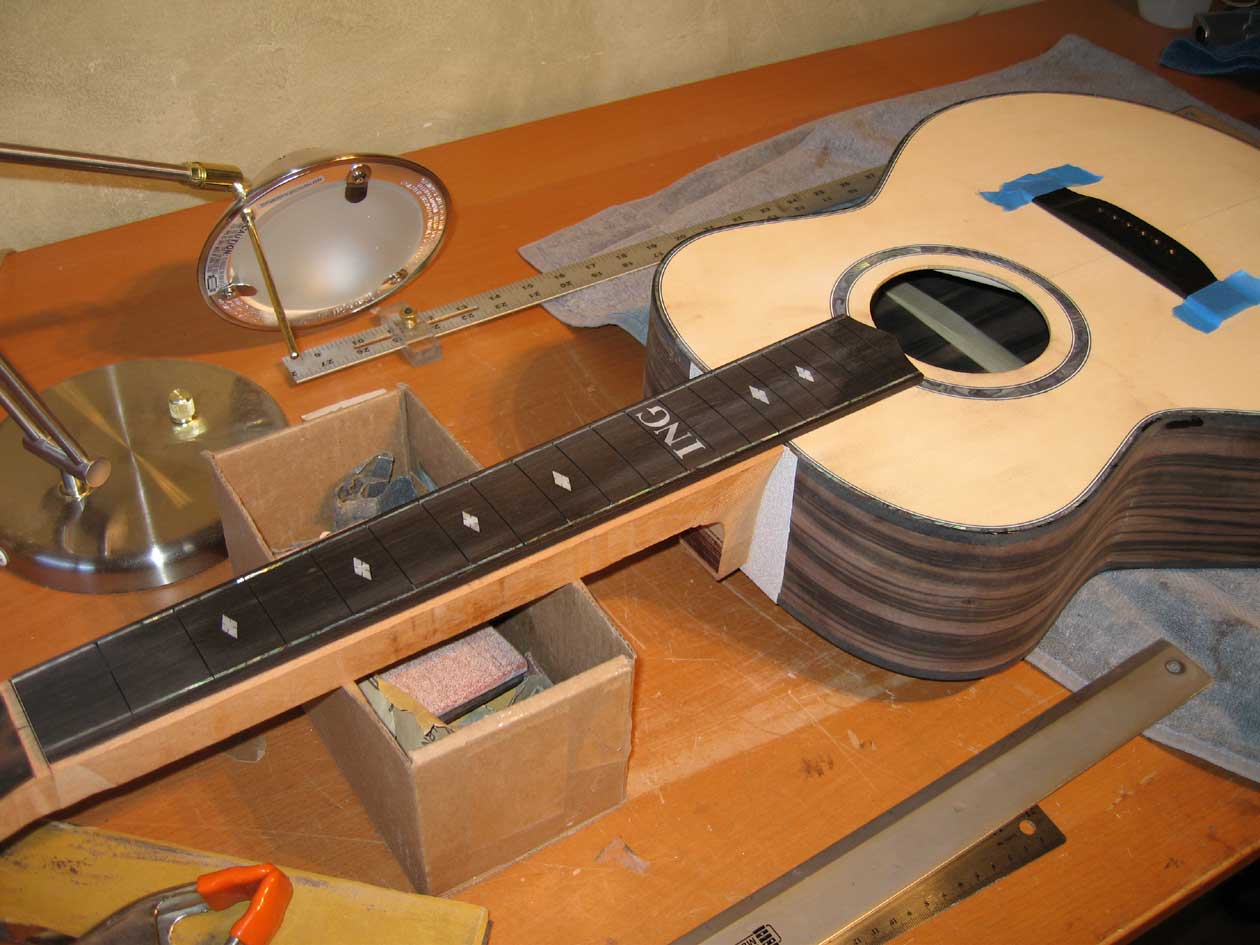

I just tried another way to level the fretboard that seems to work well.
Especially if you like to fret your fretboard before attaching to the neck.
It is simple and worked well.
I typically try to build my guitars so that the neck angle matches exactly
the body angle. So with a dead level fretboard, the bridge position and
height are perfect for my saddle. (No change in angle at the 14th fret.)
(neck angle figured out in the design of the guitar for optimal bridge and
saddle height)
But I like to fret before attaching by pressing in the frets. Obviously this
doesn't get you a chance to level on the body of the guitar which is
probably the best.

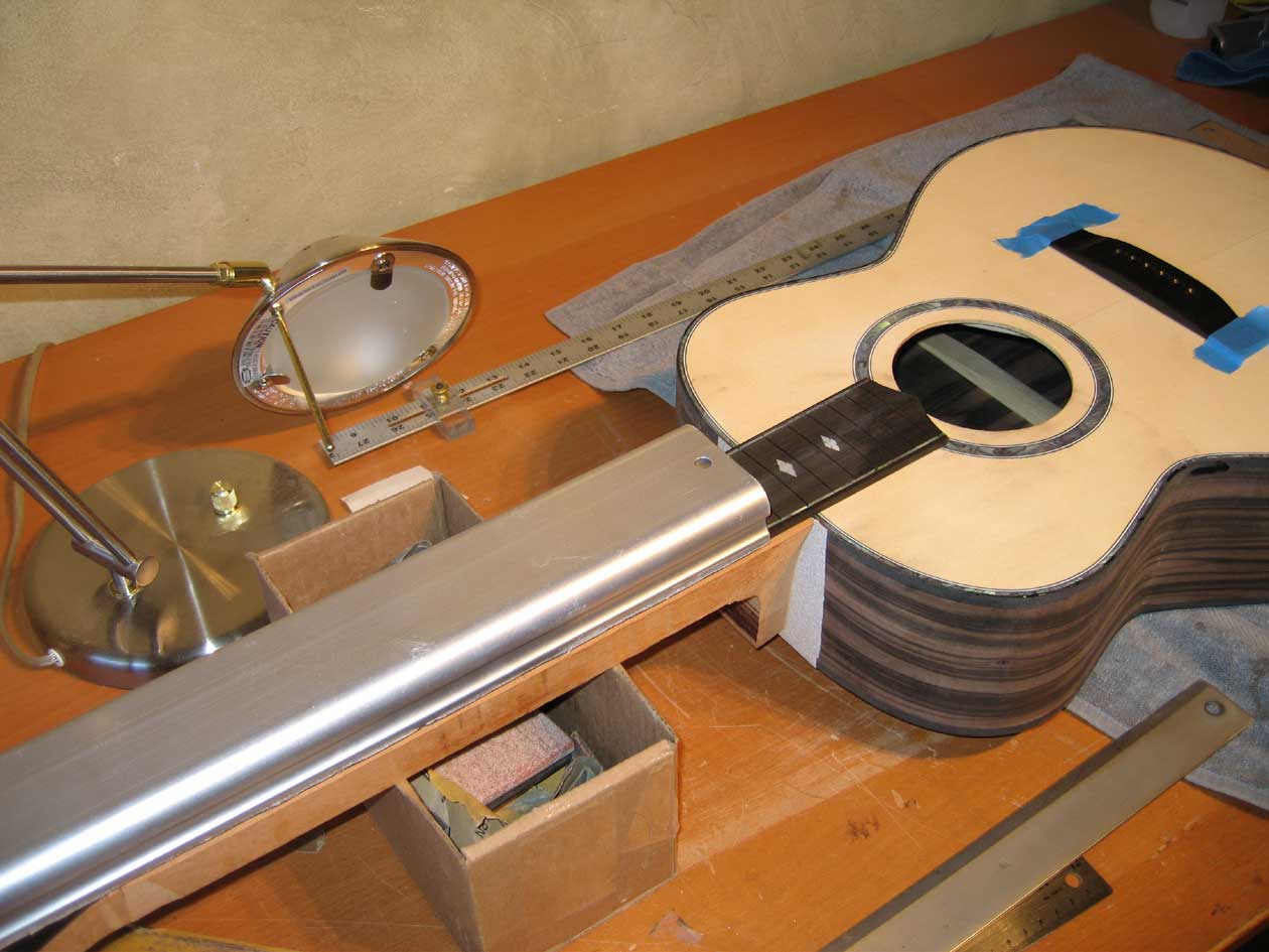

This time after setting the neck to the body dead level with out the
fretboard, I simply attached the fretboard with very thin 2 sided tape.
Leveled the fretboard on the body and neck. I then took the fretboard off
to fret. I know that the 2 sided tape is not the same as a glue joint, but
it seemed pretty tight.
Has anyone else tried this???? Any comments or Suggestions???

PostPosted: Sun Mar 19, 2006 6:50 am
Andy, I attach the neck and level, remove the neck and glue on the fretboard, attach and level, remove again and press all the frets, using the extension caul that Cumpiano has in his book. I leave the caul attached to the neck until I'm ready for final attachment and gluing. No backbow and no hump. After it's glued down, the frets can be leveled if needed. My first didn't need it.
